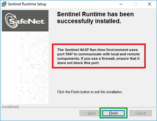

Once drivers are properly installed, you will get a completion screen such as the one shown below. Please note, if you have a Network Key, you will need to ensure port 1947 is open for both TCP and UDP traffic.
