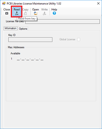

2. Click the "Read" icon.
NOTE: If you get an error, make sure your key is connected and you see it in the Admin Control Center.

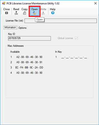

4. Click the "Open" icon, and select the TXT license file that was sent to you.

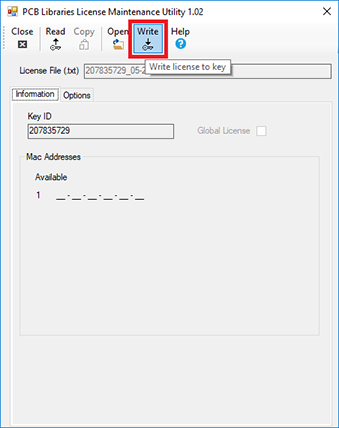

5. Click the "Write" icon, after which you should get a "License write complete" confirmation message.
If you want to make sure your update was successful, select the "Options" tab and confirm.
