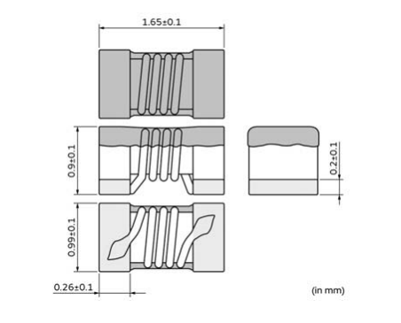

Hi to all:
I am trying to create a footprint of a wirebound inductor, Murata LQW18AN5N6G80D.
I configured my component as an SMD/Chip/Inductor and as the metalization of the pin part is not the height of the component, I configured the height of the part as the height of the metalization.
How do you resolve that kind of components?
Thanks for your comments.

These Inductors are becoming more popular these days. There should be a mfr. recommended pattern for the footprint. If not, the pad size is:
Heel = 0.00 but you need to compensate for the +/- body length tolerance of 0.10
Side = 50% of the metal thickness height up the side (Maximum)
Toe = 100% of the metal thickness height up the side (Maximum)
So the pad size for this part is 0.56 L X 1.20 W. Add 0.05 for the Heel to compensate for the tolerance.

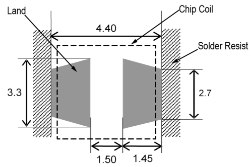

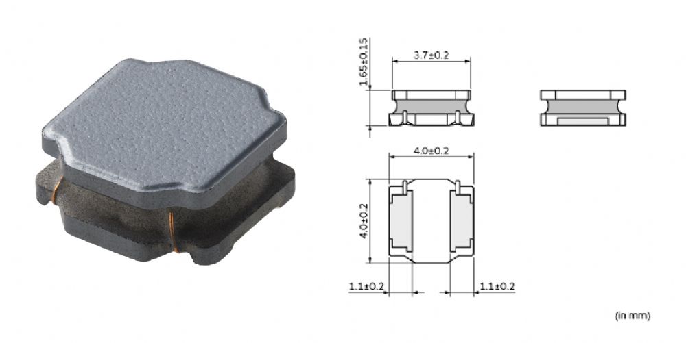

Hi all,
I'm trying to create footprint for an inductor like on the next picture:
What would be the best type to use for this inductor (Chip Inductor or DFN 2 pins  Inductor).
I'm asking this because I want to have IPC name for this footprint and when I create footprint with both types I got different name. So what would be the best solution for this.
It's Murata LQH44PN150MPRL

This Murata LQH44PN150MPRL have a trapezoid pad shape.
It cannot be created in Footprint Expert, but we can build it in a CAD tool and export/import the ASCII file into FPX format.
