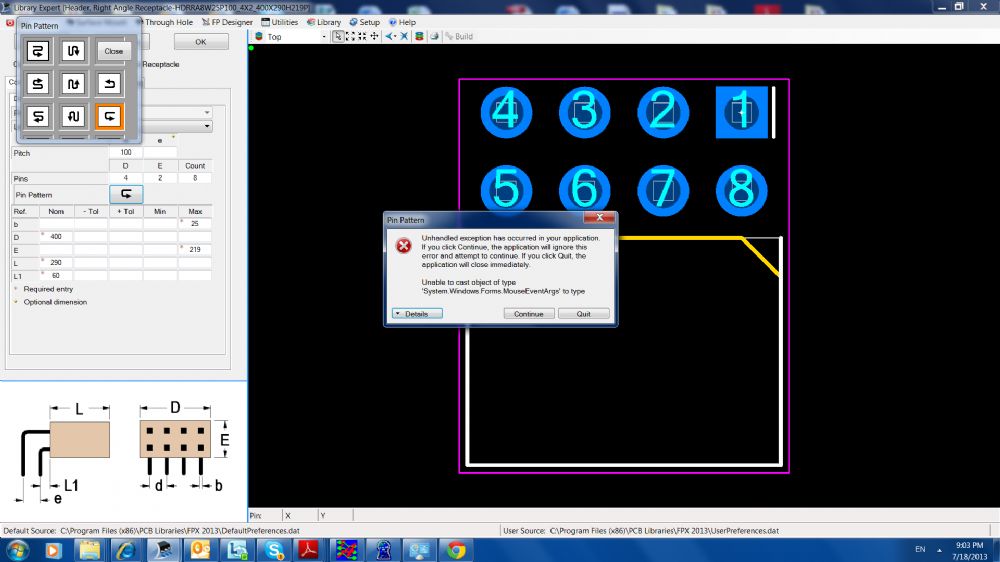

I am not able to select the pin pattern compared to previous "PCB Footprint Expert V2012", only 8 selected pin pattern is available, the rest of the option have been disable and will pop out error if I try to select them.

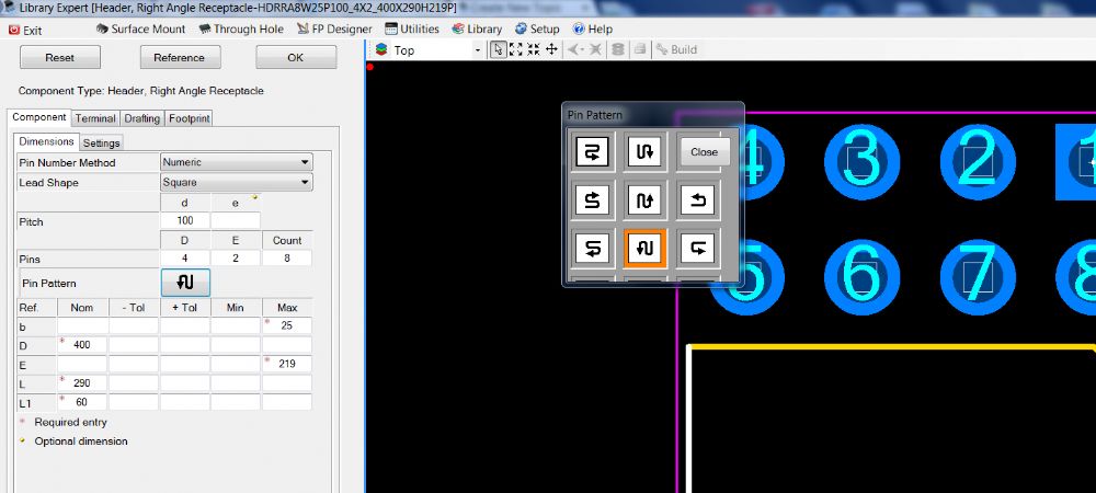

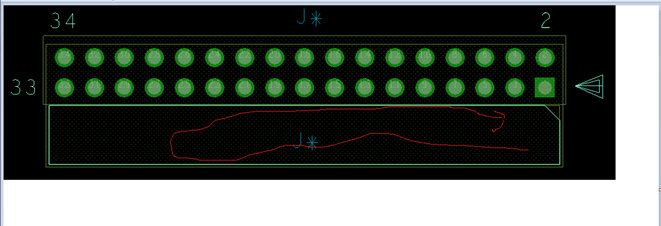

Maybe i am not describe well enough the bugs, I wished to create header that have pin 1 indicator as below and i not able to choose the pin pattern from version 2013.
From version 2012's pin pattern (left side), you can see all the pin pattern's option is available:
For version 2013's pin pattern(right side), limited option is available and i not able to stretch the window, force to click the blank option will give me errors as above.
This is nothing related to the licensing issues as I as able to create the desired FP using the older 2012 PCB Footprint Expert Lite version.

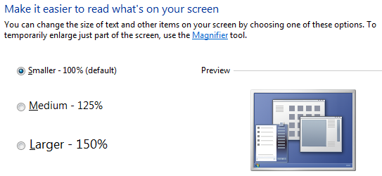

Post Options Post Options   Thanks (0) Thanks(0)   Quote Tom H Quote  Post ReplyReply Direct Link To This Post Posted: 18 Jul 2013 at 12:09pm
This issue might have to do with "Windows 7" Fonts.
zslow View Drop Down
Joined: 31 Jul 2012
Location: malaysia
Points: 12
Post Options Post Options   Thanks (0) Thanks(0)   Quote zslow Quote  Post ReplyReply Direct Link To This Post Posted: 19 Jul 2013 at 6:57am
This solves the problem. Thanks.
