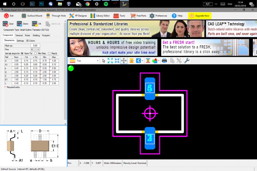

I am totally new to this software. Been very useful, however i need SOT23-6 while i can only find the 3 pinned version in the list of the software.
By the way i am a free version user.
Can someone advise me how to find the 6 pin version please!
Thanks

There is a drop-down option for pin Qty. for 3, 4, 5, 6 and 8 pin SOT-23 packages.
It's located in Surface Mount > SOT23 > Pin Pitch > Pins Drop-Down

Thanks for the reply. i have already tried that but unfortunately it does not change anything. It does not neither change the schematic icon nor gives me options for extra pins. It seems like it stacks up the pins on top of each other!

The Pin Pitch "e" dimension cannot be 0.00.
It need to be 0.95 or 0.65 or 0.50 or anything but 0.00.
