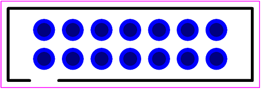

This picture has a courtyard (magenta) and a silkscreen outline. Can you immediately tell where Pin 1 is? Can the assembly shop tell where pin 1 is?
I would like constructive feedback on why this type of polarity marking is OK or not good.

The part in question looks like it would be hand placed.
In that context I would argue that the primary use of the silkscreen is as an assembly aid, and therefore it should mimic/emphasise the obvious/non-obvious polarizing feature(s) of the part.
So for this part I would show a gap in the silkscreen, but where the notch is placed. Possibly even the number (14) could be shown.
 - Looking at your picture, yes, I can immediately tell where pin 1 is. I am not sure if it will be as obvious in real life because cutout is very small (~1 mm). And what if there is a slight offset (either of silkscreen or connector)?
 - What if we use the same connector but in SMD package? Then we cannot place cutout of silkscreen directly at that pin. In addition, there is no much space between the first pin and the top of connector.

I could work it out.  This is a "grey area" because I specifically advise on my silkscreen layers that the silkscreen should not be used for component assembly - that's what the centroid x/y data and assembly drawing is for.  I'm happy for pin 1 on the assembly drawing to be a dot or a triangle or chamfered corner, as long as it's noticeable.
That said the silkcreen should still be useful as an aid for hand-insertion.  Whether it's a dot or a line doesn't matter as long as there's a consistant style on the board and for a particular customer.
Personally on some connectors I add silkcreen to resemble the connector in some way to make it clear.
On a screw terminal block I add a solid block of silkscreen to indicate the back, solid end of the connector.
On a wire to board connector with a friction lock such as the Molex 22-27-2xx1 series I will add solid silkscreen blocks for the friction lock.
On an IDC shrouded header I will add a solid silkcreen block to indicate the polarising cut-out in the shroud where it doesn't interfere with the pads.
If I can't do anything obvious and sensible then I will leave it to the assembly diagram to show it more clearly and add a line for pin 1.
