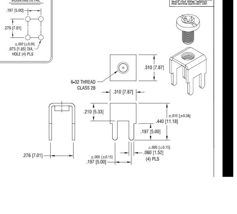

We are using screw terminals on pcb, shown in below image, We have created land pattern asper our  standards. My doubt is  in top of board we  are not given in route or via keepouts . is this ok ? else we need give any keep outs  pls suggest any one? this is the part number (8191 Keystone Electronics)
Points: 6076
Post Options Post Options   Thanks (0) Thanks(0)   Quote Tom H Quote  Post ReplyReply Direct Link To This Post Posted: 30 Aug 2012 at 7:43am
You could probably put vias in the area if you "Tent" them (cover with solder mask).
The screw terminal is used for wires and having a no via keepout will prevent the wire from touching any of them (if they are not Tented).

Post Options Post Options   Thanks (0) Thanks(0)   Quote Mattylad Quote  Post ReplyReply Direct Link To This Post Posted: 30 Aug 2012 at 11:48am
Muthu - what CAD software do you use?
As suggested, route and via keepout areas need placing on the component.
This is simple in CADSTAR, what do you use?

Post Options Post Options   Thanks (0) Thanks(0)   Quote muthu Quote  Post ReplyReply Direct Link To This Post Posted: 31 Aug 2012 at 4:34am
Cadance Allegro
My doubt is either wire will be mount on top of the screw or in bettwen of slot side.
