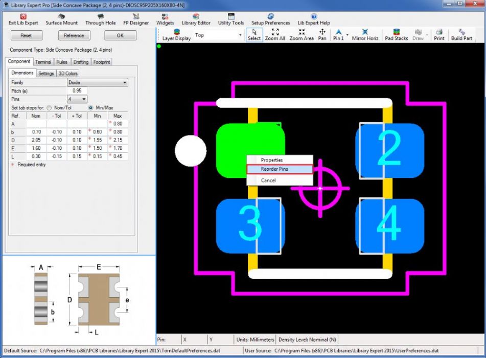

Hello.

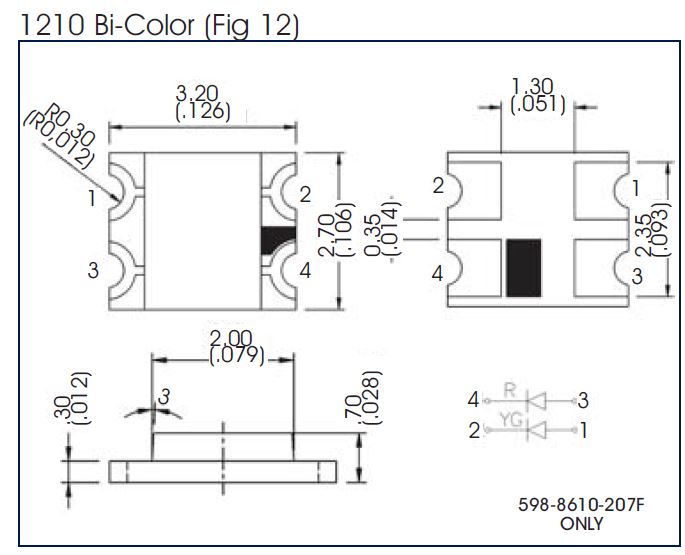

I have a package that has the markings on pin 4 and NOT pin 1.
Is there a way to change "pin 1" to another pin, say 4?
Regards,
Luke
Post Options Post Options   Thanks (0) Thanks(0)   Quote Tom H Quote  Post ReplyReply Direct Link To This Post Posted: 07 May 2015 at 9:12am
You should be using the "Side Concave Package (2, 4 pins) component family.
You can select any Pin and RMB > Reorder pins. But it looks like the default pin assignment matches the default calculator pin assignment.
