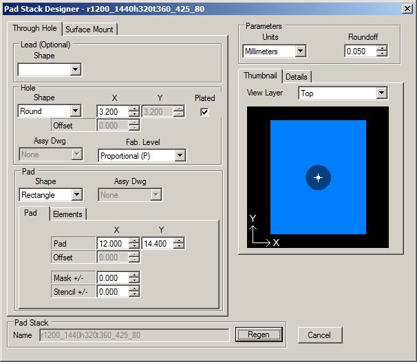

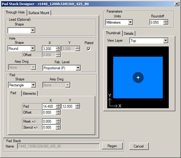

In Pad Stack Designer Library Expert Lite 2014.11 this happens.
When pad Y > X then Offset is disabled.
When pad X > Y then Offset is enabled.
Why?
Post Options Post Options   Thanks (0) Thanks(0)   Quote Tom H Quote  Post ReplyReply Direct Link To This Post Posted: 23 Sep 2014 at 6:11am
Because the Offset is under the "X" column.
If you want to offset the hole, X must be greater than Y.
You can always rotate the pad stack.
Points: 498
Post Options Post Options   Thanks (0) Thanks(0)   Quote Jeff.M Quote  Post ReplyReply Direct Link To This Post Posted: 23 Sep 2014 at 7:00am
Offset is only available in the X axis.  As such X must exceed Y.
