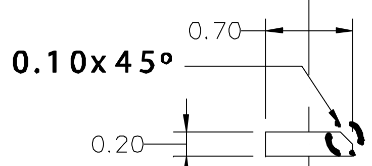

I want to set the pad corner style only on one edge because the pad looks like this:
The editor does it on both edges:

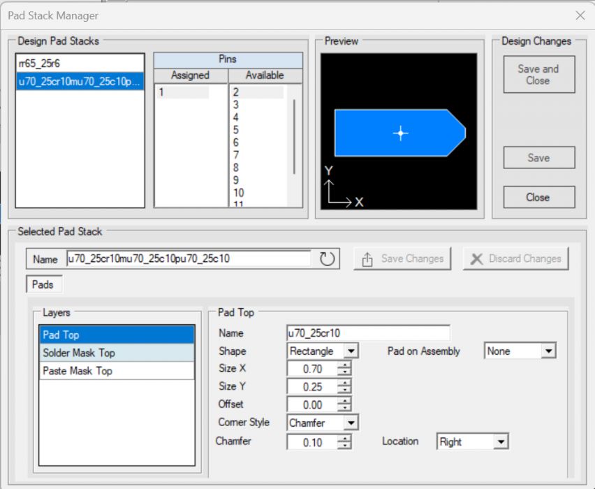

In the Pad Stack Designer select the Pad Shape 'Both' Rounded & Chamfer.
Then make the Rounded radius zero '0' and make the Chamfer any value.
Then move the Chamfer Corner to any corner.
Let us know if this works for you.
