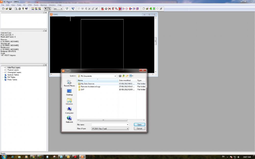

HI Matty, Just checking my latest install of GC Preview, seems like they already support  IPC2581 Big smile
UPDATE...
I downloaded testcase 1 from the IPC website
But GC Preview wouldn't open the file, so I downloaded the Free Vu2581 viewer and seems to work ok, but differently from GC Preview.
