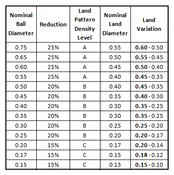

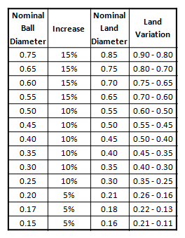

Looking at the tables below, for non-collapsing we use 0.25 (or less) nominal land diameter  for 0.50mm pitch packages. Question is, should 0.30-0.75 ball diameter still applicable for 0.500 pitch packages? Will the land pads not cause any bridging due to space constraints?
Similary, for collapsing we use 0.30 (or higher) nominal land diameter for 0.65mm pitch packages. Question is, should 0.15-0.25 ball diameter still applicable for 0.65 pitch packages? Will the land pads not cause any reliability issues due to smaller pads?
Thanks in advance for your help.
Collapsing Ball
Non-collapsing
Non-collapsing

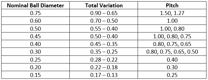

Post Options Post Options   Thanks (1) Thanks(1)   Quote Tom H Quote  Post ReplyReply Direct Link To This Post Posted: 11 Jun 2015 at 7:19am
Here is the Ball Size to Pin Pitch table from IPC-7351B:
