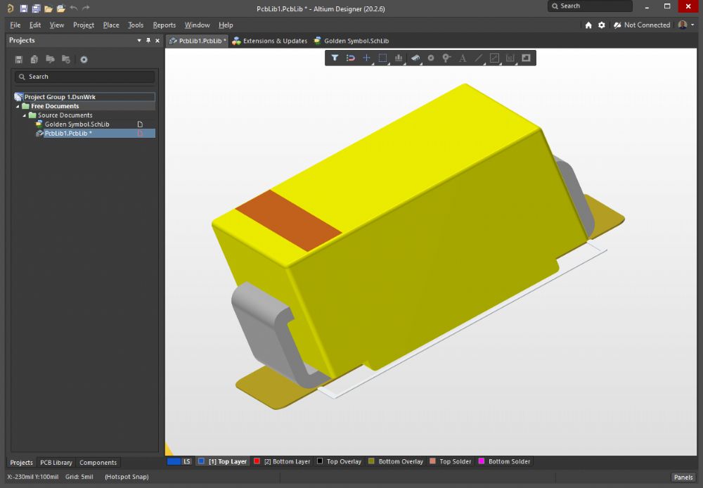

I'd like to report that the 3D Step model is not generated by selecting SMD Molded Body Capacitor Polarized.

I can't reproduce this. I'm using Library Expert V2020.03.

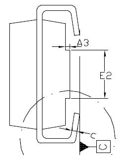

The Molded Body component family uses the JEDEC DO-214 as the main model.
Note: the "D" dimension MUST be at least 0.80 mm larger than the "D1" dimension or the 3D STEP model will be corrupt.
The Terminal Lead thickness is 0.20 mm on both sides, and it needs 0.20 mm lead bend radius.
If you still have a problem, you will have to upgrade to V2022.02 pre-release (is the latest version right now). Or the last release V2022.01.
