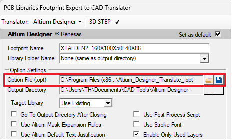

If you experience one of these issues:
  1. Footprint Expert installation is overwriting your Master Options file, or
  2. CAD tool translator is not working correctly

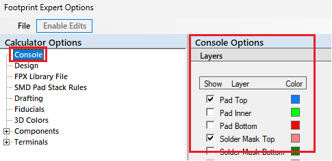

It is probably because you are using the same OPT options file as both your "CAD tool translator" OPT file and "Master Options" file. These two are separate files. As a matter of fact, there are three OPT option files:
1. Console Options - edit in Tools > Options
2. Master Options
3. CAD Tool Options
- edit in the "Build Footprint" window
