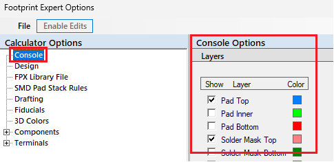

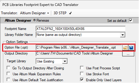

It is probably because you are using the same OPT options file as both your "CAD tool translator" OPT file and "Master Options" file. These two are separate files. As a matter of fact, there are three OPT option files:
1. Console Options - edit in Tools > Options
2. Master Options
3. CAD Tool Options
- edit in the "Build Footprint" window
