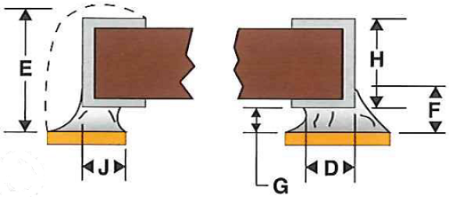

The Toe solder joint goal is the most important for the Chip Terminal Lead and the J-STD-001 Minimum Fillet Height for a Chip Component for the Toe Goal is:
The F dimension for Toe Fillet for Class 1 & Class 2 Fabrication is:
  • Wetting is evident on the vertical surface of the component terminal
The F dimension for Toe Fillet for Class 3 Fabrication is:
  • (G) + 25% (H) or (G) + 0.5 mm, whichever is less
Example: For Class 3, let’s say that the 0805 Chip Capacitor is 4.00 mm height. 25% of 4 = 1.00 mm. But the IPC-J-STD-001 standard says the 0.50 mm is an acceptable solder fillet height because it’s less than 1.00 mm. But what about an 01005 chip resistor with a 0.13 mm height? Using a 0.075 stencil thickness, J-STD-001 recommends a Toe fillet of (G) 0.07 + 25% (H) 0.03 mm = 0.10 mm. But (G) is actually less than 0.05 mm after reflow.

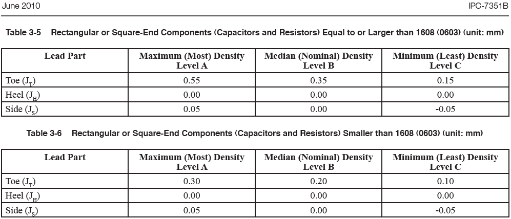

Here are the IPC-7351B tables for all chip packages including Resistors, Capacitors, Diodes, Inductors, Antennas, Ferrite Beads, Filters, Fuses, LED’s, Thermistors and Varistors for 3 density levels, Most, Nominal and Least pad size.
Note that for all chips longer than a 0603, the Nominal Toe value is 0.35 mm for 0603, 0805, 1206, 1210, 1812, 2010 and 2512, regardless of their height. And for every chip package less than 0603 the Nominal Toe value is 0.20 for 03015, 01005, 0201 and 0402. Also note that the difference between density levels for chips larger than 0603 is +/- 0.20 mm for Most and Least density levels and chips smaller than 0603 have a +/- 0.10 mm difference between Most and Least density levels.

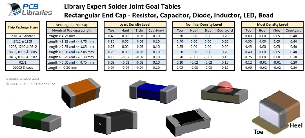

PCB Libraries, Inc. has a philosophy that every chip size should have a unique Toe value that is aligned with J-STD-001 mathematical model for the acceptable solder joint.
Here is a table for the default values in Library Expert, but all of these settings are user definable to best meet your assembly attachment requirements. Also note that there is a +/- 0.10 mm between Most and Least density levels for all chips.
PCB Libraries, Inc. refers to this concept as “Incremental Pad Stacks” for the sole purpose of achieving the best solder joint goals in the assembly process. You can download the entire Library Expert Solder Joint Goals Excel spreadsheet here – www.pcblibraries.com/downloads or if you’re using Library Expert, the Excel spreadsheet is on your computer in this folder - C:\Program Files (x86)\PCB Libraries\Library Expert 2019\Documents\Library Expert Solder Joint Goal Tables.xlsx

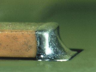

It’s also important to note that Lead Solder flows much better than Lead-Free Solder. Here is an image of a chip with lead solder. You can visually see that the solder flows from the pad Toe up the side of the chip terminal. Also note that the pad Heel is 0.00 and flush with the chip terminal.

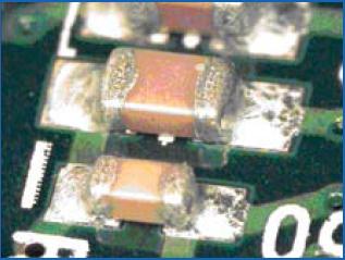

Here is an image of chips using Lead-Free solder. Most of the solder just stays on the pad and does not flow up the side of the chip terminal lead like Lead Solder. Also, this example illustrates excessive pad Toe. This consumes important PCB real estate, wastes solder and does nothing to add to the solder joint quality.
