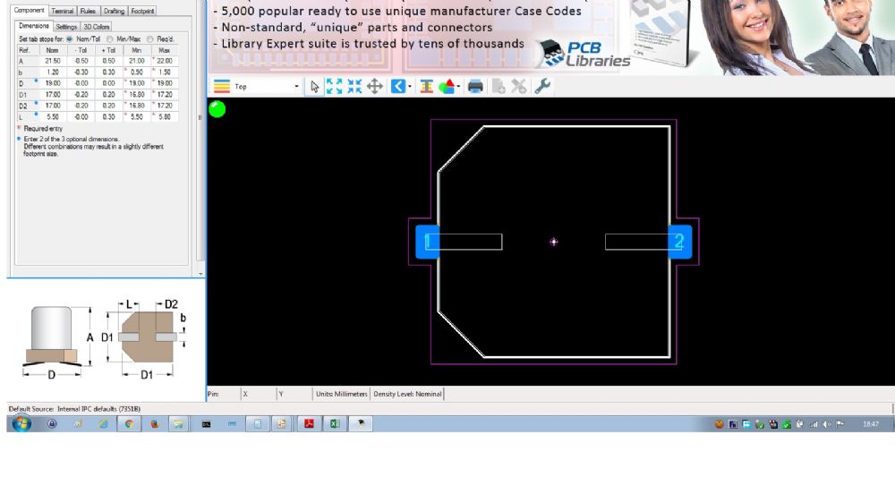

I am new to this tool.
I was trying to generate a footprint foor SMD Aluminium Capacitorm but no success !
whats wrong am doing? please help

Do you see the blue dots in the dimensions?
Only enter any 2 of 3 that you want and never enter all 3. You'll get bad results due to over calculation of tolerances.

Ahh..yes, I missed it.
It got worked now..Smile.

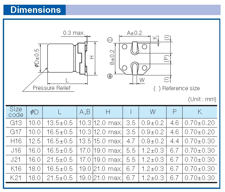

In the component data sheet by the mafr the pads values are : L=5.5, W=1.2+-0.3, P=6.7 . is this values are based on nominal or most or least?
and the generated footprints measurement were :
Most             Nominal        Least
L=6.83         L=6.46         L=6.12
W=2.7          W=2.52        W=2.31   other dimensions like outline and courtyards also varies, i didt checked.
here I got the width of the pads entirely wrong it seems?
and its a bit confusing which footprint (n,m,l) to use , in the internet most people suggests to use nominal footprints.
Actually what is the best practice to follow?

Most people use Nominal Density Level, which is a default setting.
Maximum Density is used for space satellites.
Least Density Level is used for RF design or extremely dense designs.

but how to get the correct pad width? instead of 1.2 +-0.3 am getting 2.51
Post Options Post Options   Thanks (0) Thanks(0)   Quote Tom H Quote  Post ReplyReply Direct Link To This Post Posted: 13 Sep 2016 at 7:38am
The solder joint goals in LE Lite are in the tab Terminal > Density Level > Toe, Heel and Side.
You can control the entire solder joint by adjusting those values.
