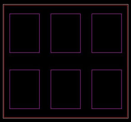

If I create a TAB padstack for a TO, DPAK shape in PCB LE Lite and built a padstack with Expedition ASCII output I get "r612_555m622_565p6xr147_192"
The paste mask name is  6xr147_192. This is a custom pad in Expedition with the name "COMPLEX 5.552X4.7 A26.0944 S6".
Please explain the custom pad syntax.
r = rectangle
612_555 = length_width of pad
m = solder mask
622_565 = length_width of solder mask
p = paste mask
6x = 6 paste mask objects
r = rectangle
147_196 = size of each paste mask rectangle
You need to download the IPC-7351 padstack naming convention here - Padstacks

Tom, I think you misunderstood me.
The explanation is for the generated custom pad with the name COMPLEX 5.552X4.7 A26.0944 S6.
Can you explain this syntax?

This is the custom pad shape name in Expedition when used with ASCII input from LE Lite.
Length X Width with an area of 26.0944, 6 squares.
Its simply a way of differentiating that complex padstack from others.

Post Options Post Options   Thanks (0) Thanks(0)   Quote PLTcbv Quote  Post ReplyReply Direct Link To This Post Posted: 04 Sep 2013 at 11:10pm
Thanks Chris.
The Length, Width and 6 squares where clear.
Only the A26.0944 was puzzling me.
Now it is clear.
