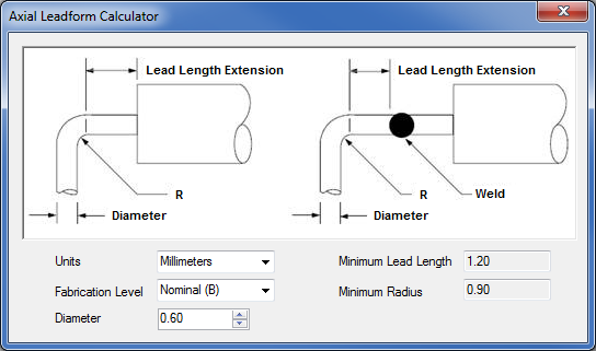

In the PCB Library Expert there is a drop-down menu called "Utilities".
Select the "Axial Leadform Calculator" -
