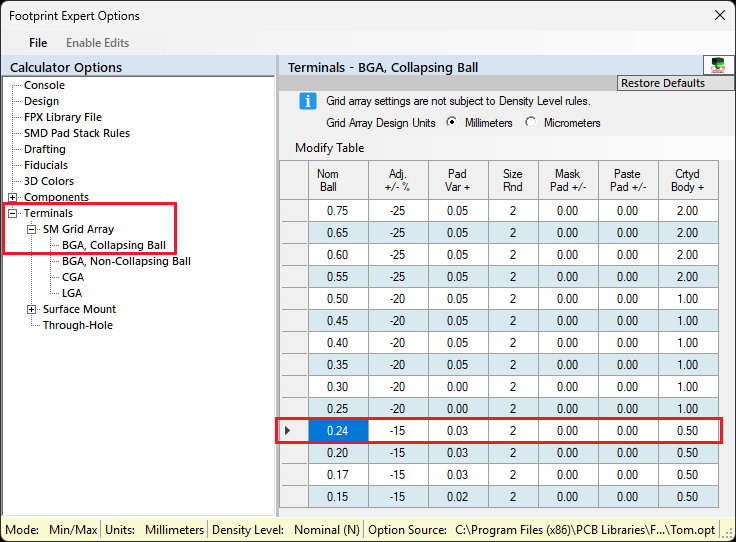

When I change density levels from "N" to "L" would I expect to see a change in Courtyard excess for BGA devices?
I see in Options\Terminals\SM Grid Array and BGA...that:
"Grid array settings are not subject to Density Level Rules.
Points: 6075
Post Options Post Options   Thanks (0) Thanks(0)   Quote Tom H Quote  Post ReplyReply Direct Link To This Post Posted: 1 hour 57 minutes ago at 8:09am
BGA's are One Tier Density Level.
Setup the BGA rules in 'Tools > Options > Terminals > Collapsing BGA'
You define all the settings per Ball Diameter. You can also add additional ball diameters.
  • Ball Diameter
  • Pad Size Reduction (Adj. +/-)
  • Tolerance (Pad Var +)
  • Pad Size Rounding
  • Solder Mask +/-
  • Paste Mask +/-
  • Courtyard Excess +
