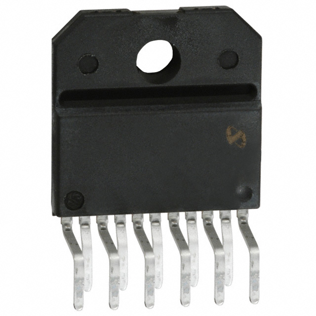

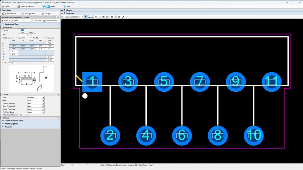

I am making footprint for LM3886 https://www.ti.com/lit/ds/symlink/lm3886.pdf
Attached is my footprint expert setting:
And here is the picture of the actual part:
You'll note that the odd pins are further away from the body of the device, unlike the generated footprint.
Unfortunately TI have not provided a recommended footprint for this package (package code NDA0011B), so I can't just use Footprint Expert.
Is there a way on the TO220 to swap which pins are furthest from device body?
Post Options Post Options   Thanks (0) Thanks(0)   Quote Tom H Quote  Post ReplyReply Direct Link To This Post Posted: 24 Apr 2024 at 3:26pm
Swap "D" and "D1" dimensions.
evan.cornell View Drop Down
Joined: 10 Sep 2018
Points: 17
Post Options Post Options   Thanks (0) Thanks(0)   Quote evan.cornell Quote  Post ReplyReply Direct Link To This Post Posted: 24 Apr 2024 at 4:58pm
That worked. Thanks!
