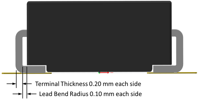

For this part” TAJB685M025RNJ” in this datasheet “http://download.siliconexpert.com/pdfs2/2026/1/22/22/20/26/9847155927/avx_/manual/taj.pdf
What PCB Model should we use to  create Footprint ?
Is it  “Molded Body”?  Correct or wrong

It is a 'Molded Body' package if the 'D1' dimension is at least 0.60 mm less than the 'D' dimension.
If the 'D1' dimension is less than 0.60 from the 'D' dimension, then it's an FP Designer footprint.

1-Please add more detail is that generic rules for simlair case if  the 'D1' dimension is less than 0.60 from the 'D' dimension, then it's an FP Designer footprint.
2- also in FP tab, create it normal  and after that choose to transfer to fp tab, or i must create it from scratch in FP tab
