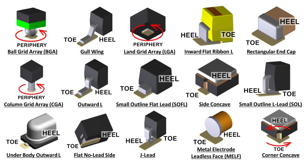

How to apply the below statement in Footprint Expert?
Create a Non-standard component package Land Pattern by calculating the minimum Toe and Heel requirements from the lead dimension given in the datasheet considering all the DFx standards in case the component manufacturer does not provide a Recommended  Land Pattern in the product datasheet/drawing.
Status: Online
Points: 5943
Post Options Post Options   Thanks (0) Thanks(0)   Quote Tom H Quote  Post ReplyReply Direct Link To This Post Posted: 1 hour 51 minutes ago at 8:50am
I've never seen a non-standard component package where the manufacturer does not provide a recommended Land Pattern.
However, if the case ever occurred where you need to calculate a pattern, you need to know the terminal lead style.
You can open a component family calculator that uses one of the terminal lead styles and enter package and terminal dimensions. Then move the footprint to FP Designer to customized the pad stack pattern.
We normally start the creation of a non-standard footprint in a component family calculator and adjust the pad shape and solder mask swell prior to moving the footprint to FP Designer.
