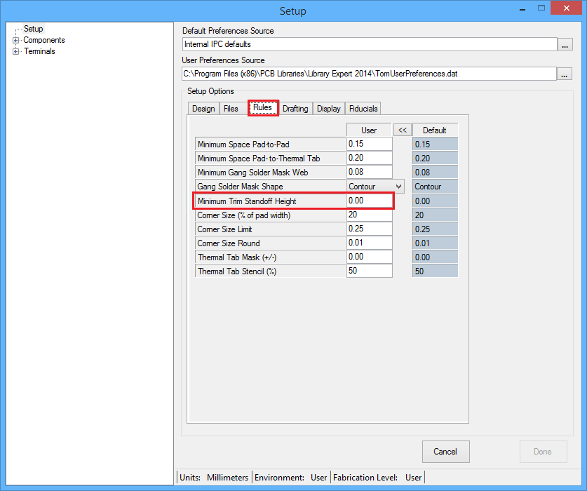

IPC Standards does not like the software default to be set to "Trim Pads Under Low stand-off Component", but the feature is still in the program and you have control of the "Stand-off Size" too.
Go to "User Preferences" and select the "Rules" tab and enter any standoff value you want to start pad trimming under component body at -

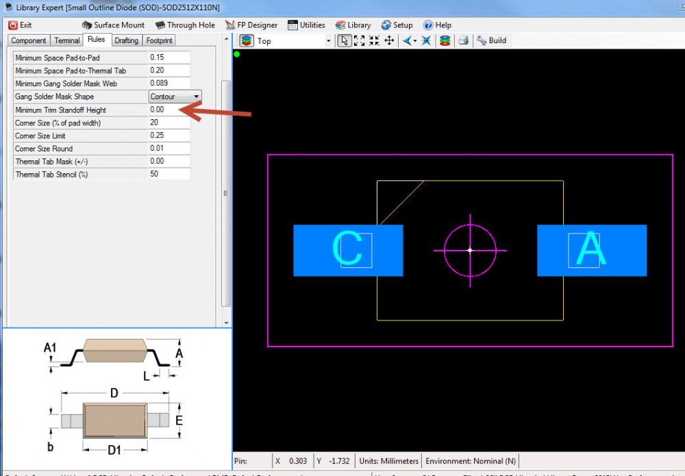

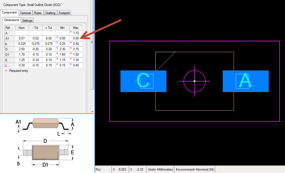

Post Options Post Options   Thanks (1) Thanks(1)   Quote RandyB Quote  Post ReplyReply Direct Link To This Post Posted: 09 Apr 2014 at 8:26am
The trim does not seem to be working SODs, either that or I do not have the rule set correctly.  See attached .jpgs
Randy
Points: 501
Post Options Post Options   Thanks (0) Thanks(0)   Quote Jeff.M Quote  Post ReplyReply Direct Link To This Post Posted: 09 Apr 2014 at 12:09pm
Trim is applied when the the Rule is set to a value greater than zero and the component standoff height (A1) dimension is less than the value entered for the rule.
That said, this is still a bug in the SOD footprint.
