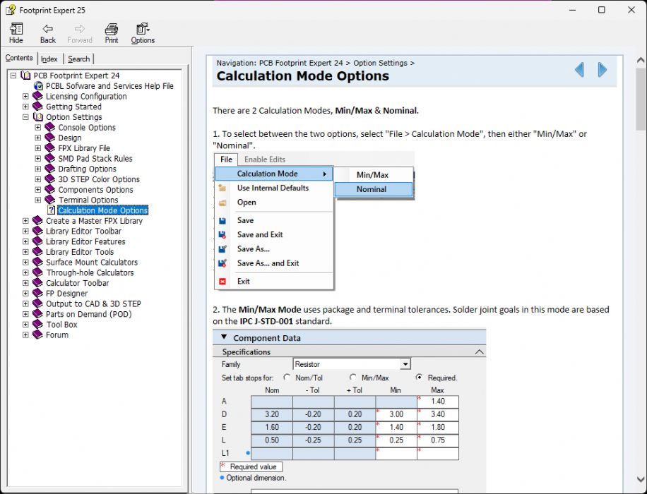

The new FED Vol 18 Nominal Calculation Mode comes with V25.02 Footprint Expert.
Switch between Min/Max and Nominal Mode in "Tools > Options > File > Calculation Mode > Min/Max or Nominal".
The new feature is located in the "Help > User Guide > Option Settings > Calculation Mode Options".
