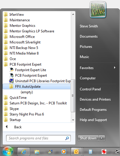

I've haven't been using Footprint Expert recently. Been on vacation, the holidays, waiting for the end of the world, etc.... But I noticed that with update 37 not only did I have the latest version but I also now had "Footprint Expert Lite" and that the FPX AutoUpdate folder was now empty.
I assumed that it would now search for updates on it own and update itself. Apparently I was wrong.  So now how do I update to the latest revision?

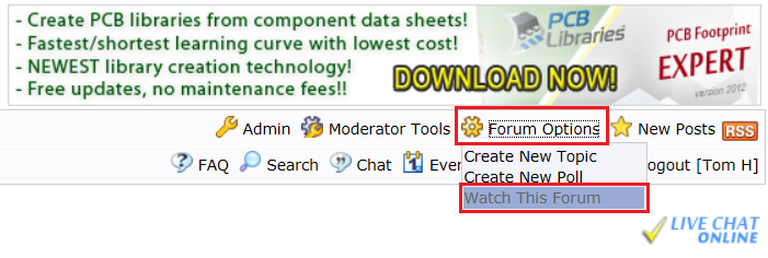

Auto-update is undergoing changes right now.
For Update Notifications, go to this forum -
Select "Forum Options > "Watch this Forum" (upper right corner)
There is an update every week and the current release is V2012.38.
There will be 2 more releases for the V2012 series .39 and .40.
On February 1, 2013 we will release V2013.01. The new version requires a HASP USB key and a small update charge (30% of the list price + $50 for a USB key if you don't have one yet).
After February 1, 2013, there will be no further updates to V2012. This is one of the reasons why Auto-update has been disabled.

Thanks Tom.  Is the downloaded file a full install or just an update?
My regards,
Steve Smith
Points: 1977
Post Options Post Options   Thanks (1) Thanks(1)   Quote Nick B Quote  Post ReplyReply Direct Link To This Post Posted: 08 Jan 2013 at 12:47pm
It's a full install.
The AutoUpdate folder you can delete, it's a remnant folder from a previous version that is no longer used.
