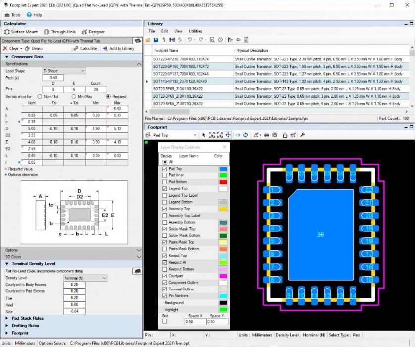

V2021 coming out in October is a 100% rewrite and the FPX file is expanded to include schematic symbols and custom 3D STEP models and optimizing the way Footprint data is stored.
You can open a V2018 format FPX file in V2021 and it will automatically upgrade to the new format. But you can't go back to V2020 or V2019. It's only upward compatible.
V2021 Preferences are now called "Options" and you will need to create a new Options .opt file. But we made the Options UI much easier to navigate and understand.
