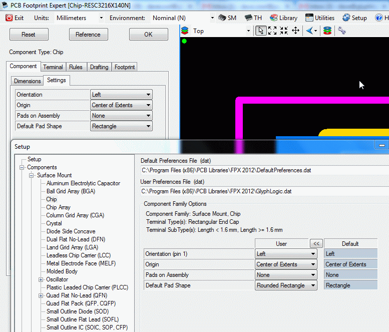

Post Options Post Options   Thanks (0) Thanks(0)   Quote DaveCowl Quote  Post ReplyReply Direct Link To This Post Posted: 27 Nov 2012 at 4:42pm
I am also confused regarding the UserPreferences.
I have created a new .dat file.
I changed the pad type for chip to Rounded Rectangle.
When I exit and restart, I can go to the Setup and I can see that Rounded Rectangle is in the user preferences, while Rectangle is in the Default.
When I go to create a new Chip part, it uses the Rectangle where I expected it to use the UserPreference indicated Rounded Rectangle.
Is there another place where I need to set which user preference file is used?
Cheers! Dave.
DaveCowl View Drop Down
Joined: 18 Oct 2012
Location: Santa Clara, CA
Points: 161
Post Options Post Options   Thanks (0) Thanks(0)   Quote DaveCowl Quote  Post ReplyReply Direct Link To This Post Posted: 27 Nov 2012 at 4:45pm
Illustration...
Joined: 18 Oct 2012
Points: 161
Post Options Post Options   Thanks (1) Thanks(1)   Quote DaveCowl Quote  Post ReplyReply Direct Link To This Post Posted: 27 Nov 2012 at 4:49pm
Nevermind - it looks like I needed to set the Environment to User.
