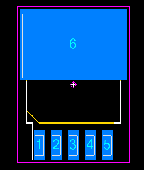

Could you confirm that this view and calculation is okay for National Semiconductor part LM2595S?
The datasheet is here:
http://www.ti.com/lit/ds/symlink/lm2595.pdf
But there's a better drawing here:
http://www.national.com/packaging/mkt/ts5b.pdf
Entered dimensions were:
D1 and D were put in as the same value.
E Min was put in as 13.85 mm based on using a +/- 0.25 mm tolerance which I used based on the main tolerance they'd used of +/- 0.25 else where on the drawing - not too disimilar to the +/- 0.2 mm tolerance suggested by Tom earlier for missing dimensions.
I took L1 from the datasheet as 1.27 max and made a similar application of a +/- 0.25 mm tolerance, then worked out E1, E, and E2.
E1 max = 1.27 + (8.64 + 0.25) = 10.16 mm
E1 min = (1.27 - 0.5) + (8.64 - 0.25) = 9.16 mm
E2 max = 1.27 + (5.08 + 0.5) = 6.85 mm
E2 min = (1.27 - 0.5) + 5.08 = 5.85 mm
L was given as 1.98 with no tolerance so again I put in a +/- 0.25 mm tolerance.
L1 max = 1.27 mm
L1 min = 1.27 - 0.5 = 0.77 mm
Dimensions shown after entry were:
Footprint view is:
Normally I'd not be too bothered if I was just doing this footprint for myself but I am conciously aware that these may end up in FPX files used by others so just wanted some feedback on what's expected for these packages.
Post Options Post Options   Thanks (1) Thanks(1)   Quote Tom H Quote  Post ReplyReply Direct Link To This Post Posted: 23 Oct 2012 at 8:27pm
The mfr. does not provide the Maximum Thermal pad length (dimension "E2").
In that case, you should always Tweak the E2 dimension so that the Pad Length is at least equal to the mfr. recommended footprint (land pattern).
The recommended footprint E2 dimension for one of the parts is -
So there are 2 different footprint patterns (2 different FPX files).
If you personally want to make a singe pattern that will fit both parts then you need to use the largest E2 value of the 2 components. You can also use the "Footprint" tab and enter the mfr recommended footprint values to create that unique pattern.
