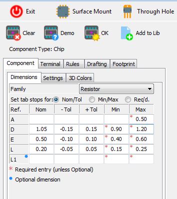

Why i can't generate footprint with tolerance not equal plus and minus and when i add values as example below it change automatically
As example  D = 1 - 0.1 +0.2 ? to be  1.05 +/- 0.15

When you have different +/- tolerances, enter the Min/Max data instead of Nominal + Tolerance.
When you enter the Min/Max data, a new Nominal dimension will be auto generated.
The Nominal = the value between the Minimum and Maximum.
This will also affect the Footprint Name, which uses the Nominal dimensions.
