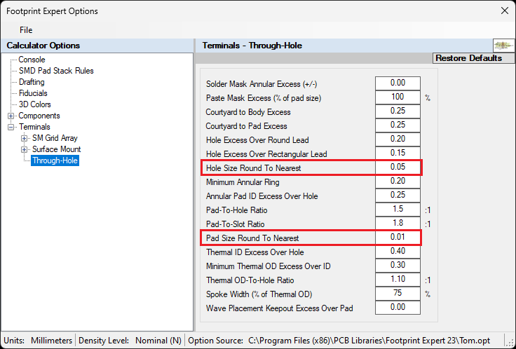

No matter how many decimal places I set in options it rounds the value to two decimal places and does that incorrectly.  .736 becomes .75 ???
For example I need a .736 hole with a 1.117 pad. The software creates a C112h75 padstack and the hole is .75 and the pad is 1.12.
Post Options Post Options   Thanks (0) Thanks(0)   Quote Tom H Quote  Post ReplyReply Direct Link To This Post Posted: 31 Jan 2023 at 10:38am
Try adjusting the values in "Tools > Options > Terminals > Through-hole
lalexman View Drop Down
Joined: 30 Jul 2012
Points: 699
Post Options Post Options   Thanks (0) Thanks(0)   Quote lalexman Quote  Post ReplyReply Direct Link To This Post Posted: 31 Jan 2023 at 10:45am
Ok. I understand now. Thanks
