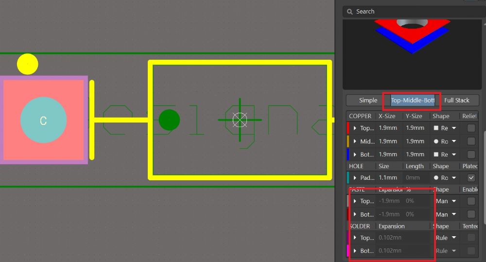

While I use Footprint Expert for creating a through-hole footprint, I find paste mask and solder mask not equal to Zero '0', also pad type not be simple type.
Attached FPX
Altium Screenshot:

What's wrong with having negative values?
When a negative paste mask value is the same value as the pad, it turns off that shape.
We don't understand what the issue is.
We know that you want to see a zero '0' for the paste mask if there is none, but having a negative value is the same thing.
