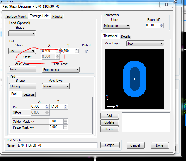

In trying to create a slot with an offset hole with respect to the pad I find that the offset function is grayed out.
Is this a bug or pilot error with a setting somewhere else?
2016.14 installed
Post Options Post Options   Thanks (0) Thanks(0)   Quote Tom H Quote  Post ReplyReply Direct Link To This Post Posted: 08 Nov 2016 at 12:02pm
You can only Offset a horizontal slotted hole (not Vertical).
Then when you place it Rotate it.
