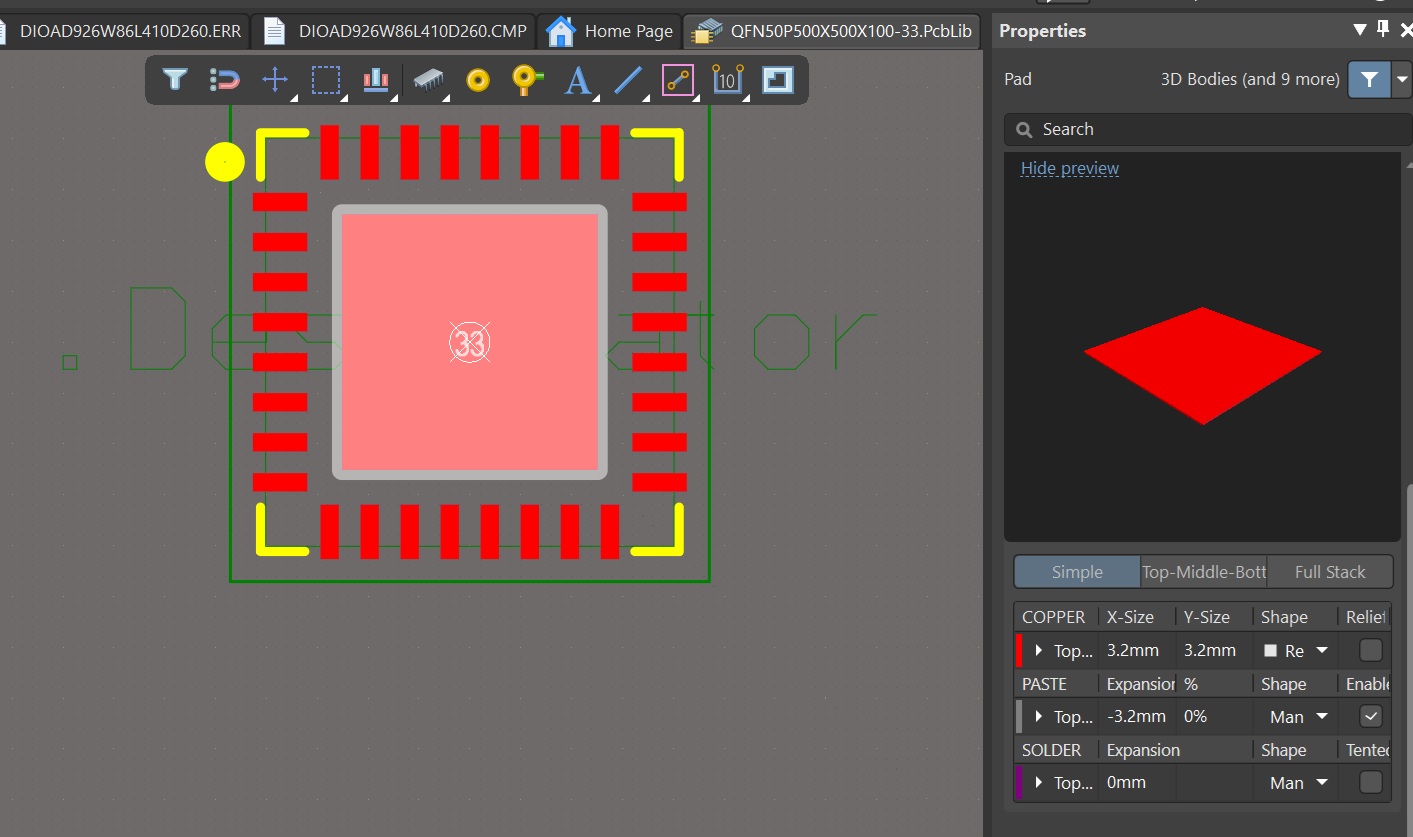

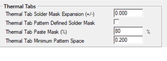

I can adjust Thermal Pad by this parameter, but when open in Altium gives wrong value.
Can have more explain how to adjust this?

Post Options Post Options   Thanks (0) Thanks(0)   Quote Tom H Quote  Post ReplyReply Direct Link To This Post Posted: 11 hours 50 minutes ago at 6:15pm
80% Paste Mask Reduction will not give you a Checker Board Pattern.
80% Paste Mask Reduction will provide a single paste mask aperture.
70% is the highest Paste Mask Reduction to generate a Checker Board Pattern.

Post Options Post Options   Thanks (0) Thanks(0)   Quote m.elsayed Quote  Post ReplyReply Direct Link To This Post Posted: 8 hours 17 minutes ago at 9:48pm
 i have attached fpx, can please we have explain on it ,
if 80% not applicable why tool not block user , rather than get wrong values, please add more details for this point, when apply 70 % what values should appears in Altium
