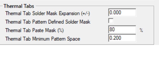

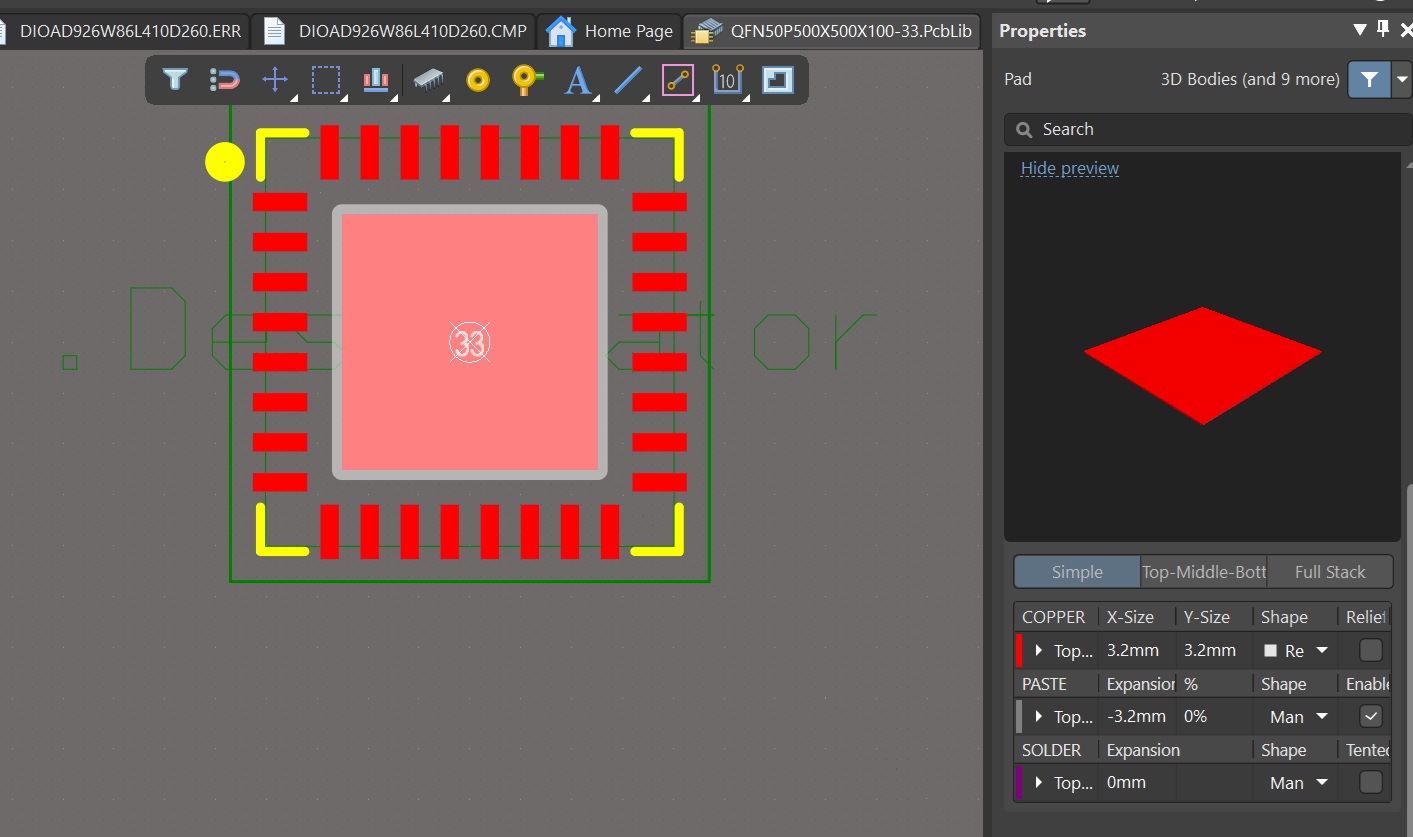

    Posted: 14 Sep 2025 at 5:56pm
I can adjust Thermal Pad by this parameter, but when open in Altium gives wrong value.
Can have more explain how to adjust this?
Points: 6031
Post Options Post Options   Thanks (0) Thanks(0)   Quote Tom H Quote  Post ReplyReply Direct Link To This Post Posted: 14 Sep 2025 at 6:15pm
80% Paste Mask Reduction will not give you a Checker Board Pattern.
80% Paste Mask Reduction will provide a single paste mask aperture.
70% is the highest Paste Mask Reduction to generate a Checker Board Pattern.

Points: 6031
Post Options Post Options   Thanks (0) Thanks(0)   Quote Tom H Quote  Post ReplyReply Direct Link To This Post Posted: 15 Sep 2025 at 7:29am
You must consider all the rules.
You have a Minimum Paste Mask web set to 0.20 mm.
You need to keep the Thermal Pad Paste Mask 0.10 mm indented from the pad edge.
80% is doable however, you're not going to get a Checker Board Pattern.
Many users set Thermal Pad Paste Mask to 100% and allow the Assembly Shop Stencil Mfr. design the paste mask reduction.
All we're saying is that we found out that 70% is the highest you can go a still get a Checker Board Pattern.
We're not going to limit the software program and not allow 80%. If you're not educated on the mathematics of paste mask reduction, and the consequences of your Option settings, that's not our responsibility. It's trial and error.

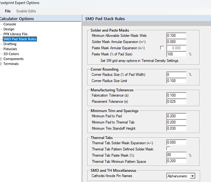

Post Options Post Options   Thanks (0) Thanks(0)   Quote m.elsayed Quote  Post ReplyReply Direct Link To This Post Posted: 16 Sep 2025 at 5:14am
Thanks alot Tom for your support and great help
the purpose of question is to get understand the information from expert one like you
and know how it works and check what issue on configuration or setting i did
can find screen below for my settings , and help
Points: 6031
Post Options Post Options   Thanks (0) Thanks(0)   Quote Tom H Quote  Post ReplyReply Direct Link To This Post Posted: 16 Sep 2025 at 7:47am
Footprint Expert had the default Thermal Pad Paste Mask Reduction setting at 50% for many years from 2004 - 2016. We bumped it up to 60% default after helping IPC develop the IPC-7093A standard in 2017.
For many years we set the Thermal Pad Paste Mask reduction should be between 40 - 60% with 70% being the limit to accommodate both the Thermal Pad Minimum Space (between checkerboard patterns) and the paste mask apertures.
80% paste mask reduction is too big to accommodate the Minimum Space and produce a checker board pattern. 80% - 100% will give you a single paste mask aperture that is 80% less than the thermal pad size.
You have to understand the mathematics involved in paste mask reduction and the minimum aperture spacing rule. You do the math and you'll see that everything works accordingly. Take any pad and reduce the size by 80% and see the results.
