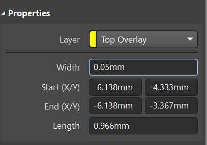

I have '+' polarity marker in Silkscreen and Assembly layers with same dimension as line width = 0.05 mm and size = 1.016 mm
However, when open in Altium Designer the '+' symbol has different dimension values.

Footprint Expert reports the length of the lines forming the cross as the maximum value.
Most CAD programs do not account for round ends when reporting the length of the lines.
If you subtract the width (0.050) from the length reported by Footprint Expert (1.016), you get the result reported by Altium Designer (0.966).

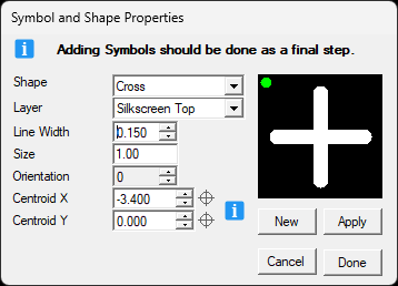

I created a Silkscreen Plus + symbol in Footprint Expert 1.00 mm X 0.15 mm line width.
Here is the Footprint Expert Symbol dialog box:
I translated the footprint to Altium and here are the Plus Symbol dimensions.
Here is the Altium Properties for the Polarity Marker:
It seems to be working 100% correct.
Can you confirm that the issue you reported is working correctly?
Points: 81
Post Options Post Options   Thanks (0) Thanks(0)   Quote m.elsayed Quote  Post ReplyReply Direct Link To This Post Posted: Yesterday at 2:20am
Thanks Tom, for your great support
I have get  your point in length, but for line width i notice below:-
1-Silkscreen
however i have selected value line width =0.05 mm and select Apply & Done, a
and then checked found it 0.15 mm (PCb tool)

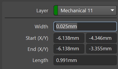

2-Assembly
however i select 0.05 mm in line width
i found it in altium as 0.025 mm
please can check and have explanation what happen and causes for this

Post Options Post Options   Thanks (1) Thanks(1)   Quote tgrodnicki Quote  Post ReplyReply Direct Link To This Post Posted: 16 hours 24 minutes ago at 11:43pm
In 25.10, 9/16/2025 prelease version the bug with Symbol and Shape Properties window has been fixed.
I don't use Altium, so I can't comment on the translator's accuracy.

Post Options Post Options   Thanks (0) Thanks(0)   Quote Tom H Quote  Post ReplyReply Direct Link To This Post Posted: 8 hours 10 minutes ago at 7:57am
The Symbol and Shape feature was fixed in the V25.10 pre-release dated 9/16/25.
Also, the new Min/Max Assembly Polarity Dot was added to Options.
The Chamfer Polarity is the default setting but users can now switch to an Assembly Dot.
