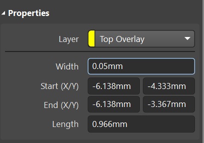

I have '+' polarity marker in Silkscreen and Assembly layers with same dimension as line width = 0.05 mm and size = 1.016 mm
However, when open in Altium Designer the '+' symbol has different dimension values.

Post Options Post Options   Thanks (1) Thanks(1)   Quote tgrodnicki Quote  Post ReplyReply Direct Link To This Post Posted: 14 Sep 2025 at 11:22pm
Footprint Expert reports the length of the lines forming the cross as the maximum value.
Most CAD programs do not account for round ends when reporting the length of the lines.
If you subtract the width (0.050) from the length reported by Footprint Expert (1.016), you get the result reported by Altium Designer (0.966).

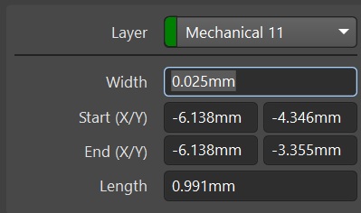

Post Options Post Options   Thanks (0) Thanks(0)   Quote m.elsayed Quote  Post ReplyReply Direct Link To This Post Posted: 20 hours 51 minutes ago at 5:51am
But also, I found in line width changed to 0.254 mm other layer assembly.
However, I changed the line width to 0.05 mm.

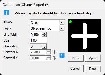

I created a Silkscreen Plus + symbol in Footprint Expert 1.00 mm X 0.15 mm line width.
Here is the Footprint Expert Symbol dialog box:

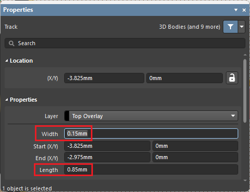

I translated the footprint to Altium and here are the Plus Symbol dimensions.
Here is the Altium Properties for the Polarity Marker:
It seems to be working 100% correct.

I have get  your point in length, but for line width i notice below:-
1-Silkscreen
however i have selected value line width =0.05 mm and select Apply & Done, a
and then checked found it 0.15 mm (PCb tool)
2-Assembly
however i select 0.05 mm in line width
i found it in altium as 0.025 mm
please can check and have explanation what happen and causes for this
