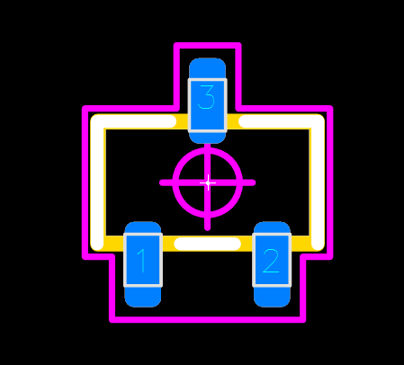

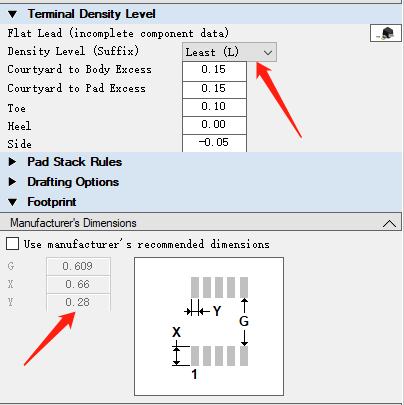

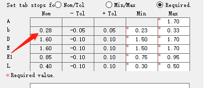

Today, I use the 2021.09 version to generate a SC89 footprint (using the SOFL package). I found the pad size in 'L' density is generated according to the nominal size. Assuming a pin with such width specification:
MIN = 0.23, NOM = 0.28, MAX = 0.33
Then the pad width generated is 0.28. Is it designed like this, or it's a bug?

Yes, I use the default solder joint goals and mfr, etc. The datasheet of the part is https://www.onsemi.com/pdf/datasheet/nta4153n-d.pdf, the SC-89 package.
Post Options Post Options   Thanks (0) Thanks(0)   Quote Tom H Quote  Post ReplyReply Direct Link To This Post Posted: 07 Jul 2021 at 9:00am
It's perfect. The pad width can not be any smaller than the nominal lead width.

I thought the pad should be equal or greater than the max. specification.  Now if the pad is generated as nominal width. we must rely on the courtyard to make sure the pad won't get connected with other, right?
Thanks.

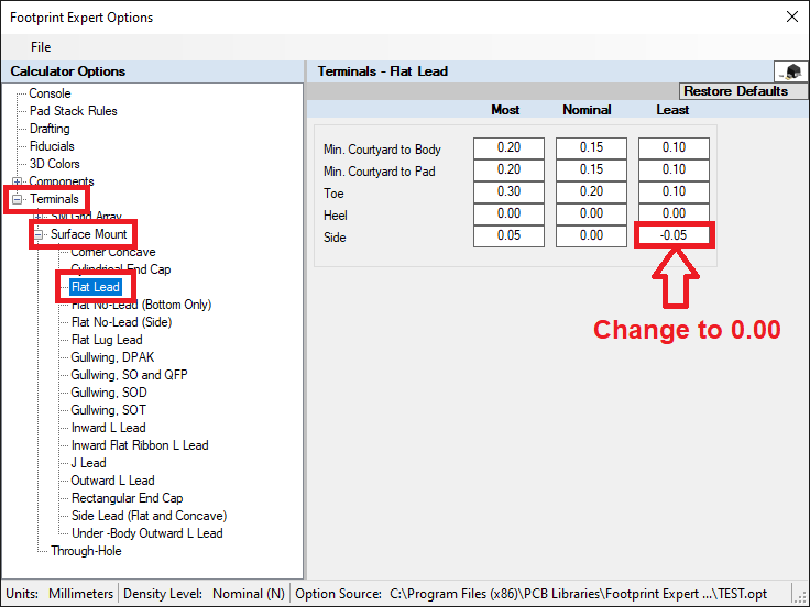

Post Options Post Options   Thanks (0) Thanks(0)   Quote Tom H Quote  Post ReplyReply Direct Link To This Post Posted: 07 Jul 2021 at 9:09pm
Not in the "Least Density Level".
Least = minimum pad size, but still functional and manufacturable.
Use Nominal Density or change the "Tools > Options > Terminals > Surface Mount > Flat Lead > Least > Side
You have the controls to create your PCB library.
