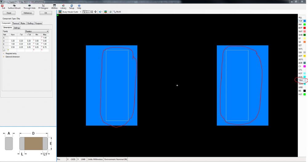

I want to export the Terminals Layer from Library Expert Pro , to Pads.
I have attached an image where i highlight the terminals and the terminals layer tab. On that image only top layer and terminals layer is currently ON.
Thanks
Points: 5985
Post Options Post Options   Thanks (0) Thanks(0)   Quote Tom H Quote  Post ReplyReply Direct Link To This Post Posted: 12 Jun 2014 at 12:09pm
Those outlines are the component terminals.
PADS does not have a layer assignment for component terminals.
What layer would you want them on?
