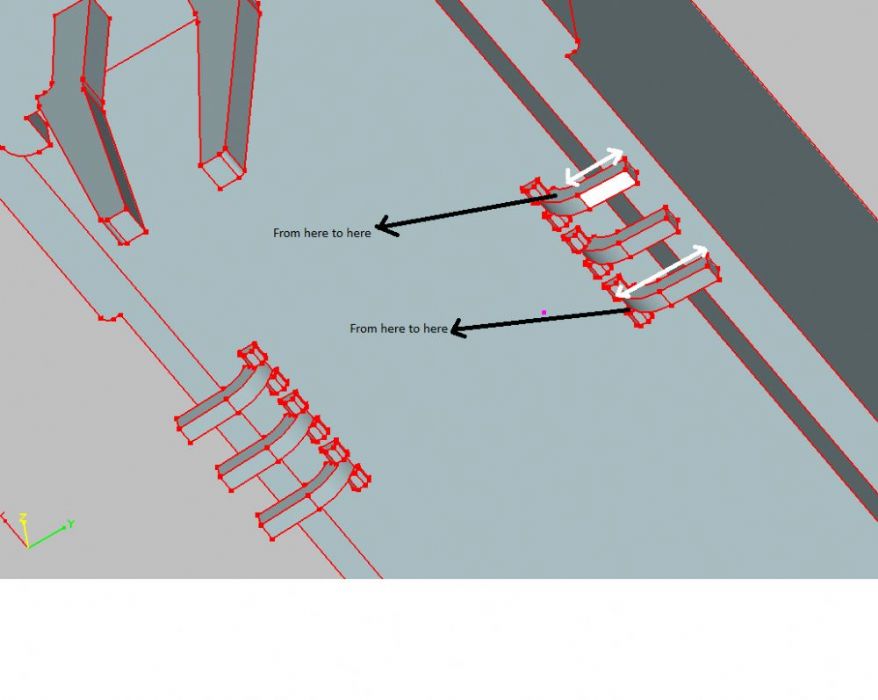

Post Options Post Options   Thanks (0) Thanks(0)   Quote mohamedjubair.k Quote  Post ReplyReply Direct Link To This Post Posted: 11 Oct 2022 at 12:48am
This is a DDR4 DIMM socket. physical pin dimension is not mentioned in component drawing. As we discussed i downloaded a 3D step file. Now my question is from where to where the pin length measurement will be. I marked 2 way in attached image.
Because, Design rule checks will be based on physical dimensions of the pin. We will inspect toe and heel joint value for a lead based upon IPC and we will confirm the CAD footprint.
So this pin length value is much important. Please educate me regarding this.
Post Options Post Options   Thanks (0) Thanks(0)   Quote Tom H Quote  Post ReplyReply Direct Link To This Post Posted: 11 Oct 2022 at 9:44am
Make the "Toe" value the same dimension as the terminal lead thickness.
Make the Heel value 0.35 mm and the side goal 0.05 mm.
The terminal length is the white area that you define in your picture.
The Pad Length is the Terminal Length + Toe + Heel.
The pad width is the Terminal width + 0.10 mm
