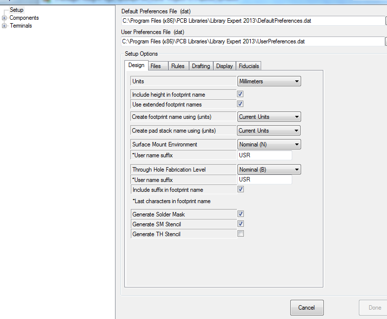

Some people get the User and Default Preferences mixed up.
In "Setup > Preferences > Design" if you select "User" it is a 1-Tier library system.
If you select Least, Nominal or Most it is a 3-Tier library system.

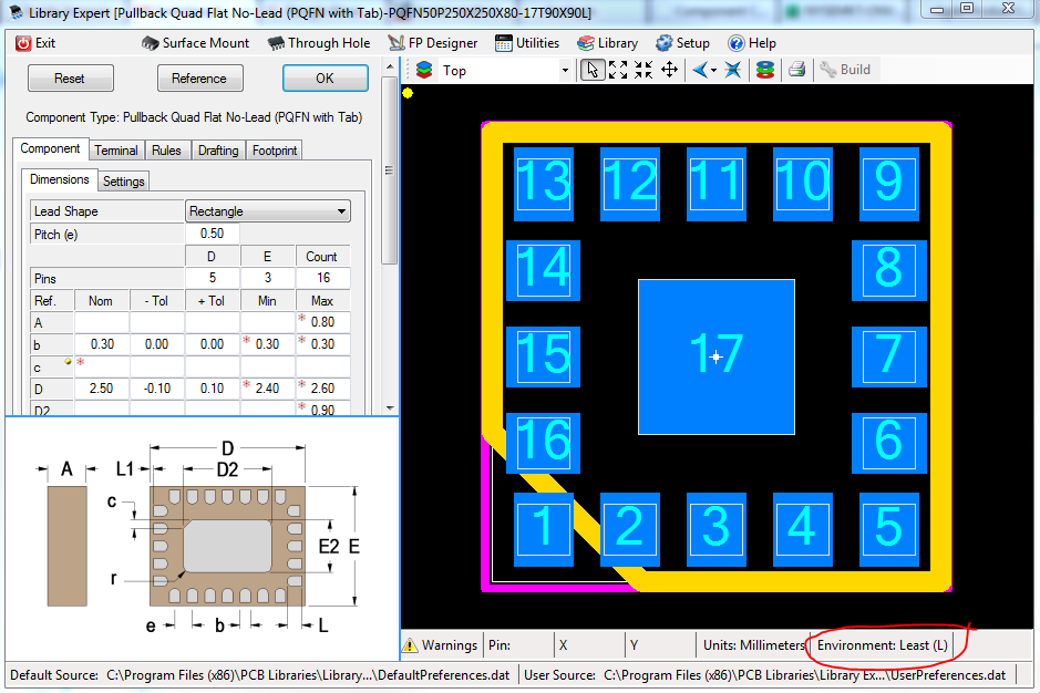

Post Options Post Options   Thanks (0) Thanks(0)   Quote BryanT Quote  Post ReplyReply Direct Link To This Post Posted: 13 Dec 2013 at 12:57pm
Tom,
I upgraded to 2013.17 yesterday.
So here's a pic of the part I did - its in the PQFN with Tab Family.  You can see that its set for the Least Env:

Post Options Post Options   Thanks (0) Thanks(0)   Quote BryanT Quote  Post ReplyReply Direct Link To This Post Posted: 13 Dec 2013 at 12:59pm
Then I changed the User Default to the Nominal Env - and then said "OK" again - should it update the footprint at that point?  It didnt in this case:

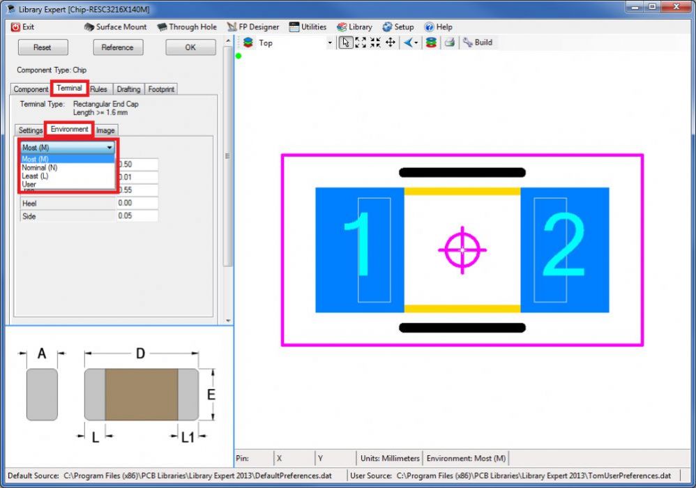

Post Options Post Options   Thanks (0) Thanks(0)   Quote Tom H Quote  Post ReplyReply Direct Link To This Post Posted: 13 Dec 2013 at 1:17pm
When you are building a single Footprint, you change the environment in the Calculator, not User Preferences. Select the "Terminal > Environment > Dropdown"
But if you change any component dimensions, the preferences will reset to whatever your defaults are set to. Hope this helps.
