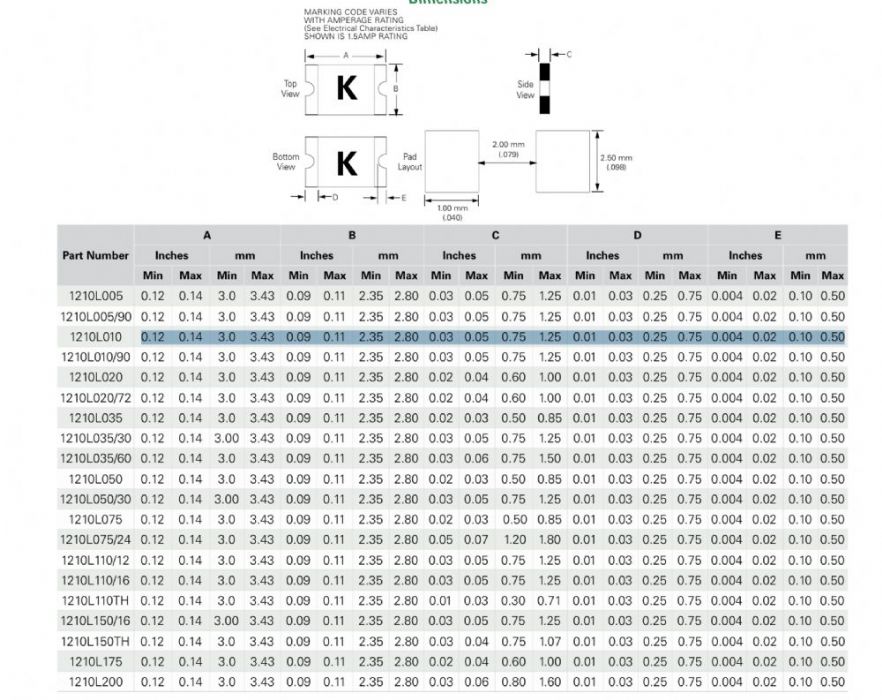

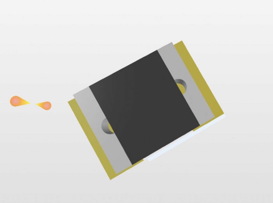

I created a side concave footprint for a fuse. When I export to Altium the 3D symbol looks strange. The concave part is not on the outside?

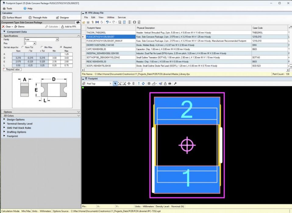

The Footprint Expert input:
Info datasheet.

We fixed this in the current V25.12 pre-release - www.pcblibaries.com/downloads ;
Let us know if this works OK for you.
