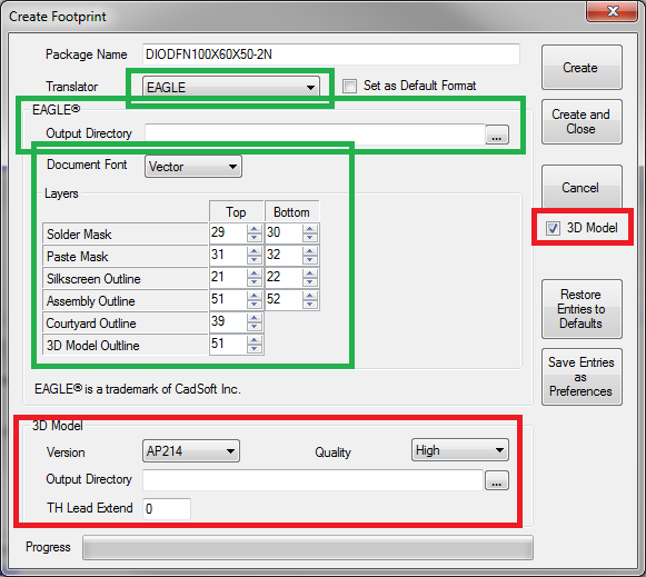

OK, Finally down and made a part I had already made in Eagle.
A P485 SOIC 20 pin. So the program generated a step file.
I need a .SCR file for Eagle to use.
What did I miss?
Can you all give me a hint?

The steps to output to any CAD format are listed under the Help menu (within the Library Expert) as well.
Points: 1977
Post Options Post Options   Thanks (0) Thanks(0)   Quote Nick B Quote  Post ReplyReply Direct Link To This Post Posted: 21 Sep 2013 at 7:53pm
I may have misread your question -- please make sure to specify an output file for both "Output Directory" fields. Do you have a valid path for both? Note the green marks are for the footprint, and the red for 3D STEP...
I assume you're using the latest 2013.13?
