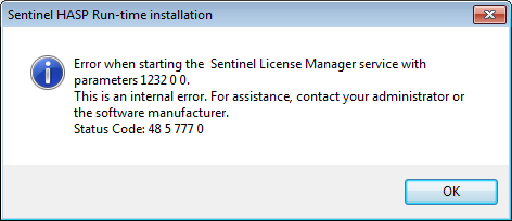

If you get the "Status Code 48" error (similar as shown below), it usually means that an anti-virus and/or firewall software is interfering with the driver installation. Try to temporarily disable such software before proceeding with the drivers installation. Also, make sure the default port 1947 is not used by any other application.
