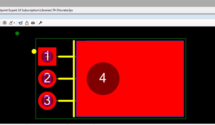

I was looking for a footprint for an SOT-32 from STMicro.  I found one in your "TH Discrete.fpx" library, a lot of the numbers in the Component Data looked correct, but D2 is definitely wrong.

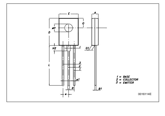

This is from the BD-135 Data Sheet:
And here is the footprint from the FPX library.  The mounting hole is obviously not in the correct position.   I understand that this footprint is a function of where the user would bend the leads, but shouldn't the footprint at least be realistic for a particular selection of where to bend?
Your user manual said to report bad footprints.  Is this the correct way to report problems?

it doesn't look like my cut/paste worked.  Here are the two snapshots I tried to send, attached to this reply.uploads/16542/BD-135_data_sheet_from_STMicro.JPG

Only looks like one of the snapshots came through.  Here is the other one.uploads/16542/PCB_Libraries_footprint_for_SOT-32.JPG

BTW: I downloaded the BD135 from "Parts-On-Demand".  There were two parts (one with a -16 at the end).  They both appear to have the same dimensional problem as the one in the installed FPX library.  Also I noticed that pin 1 and 3 are reversed from the STMicro datasheet.  I did do an "issue report" on one of them.
