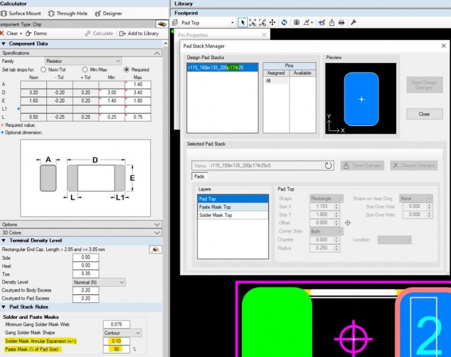

Hello All,
i missed some default settings.
- "Pad Size Roundoff" for the TH Terminals
- "Solder Mask Annular Expansion"
- "Paste Mask (% of Pad Size)"
Also when the padstack is created it generates wrong pad names.
I checked the demo values for Chip Resistor and set "Solder mask .." to 0.1 and the Paste to 90% the program generates a name like in the picture in 2 diffrent versions.
Best Regards
Olaf Mueller
Post Options Post Options   Thanks (0) Thanks(0)   Quote Tom H Quote  Post ReplyReply Direct Link To This Post Posted: 16 Apr 2021 at 8:07am
You have "File > Options > Pad Stack Rules > SMD Solder and Paste Masks" to globally set your Solder Mask and Paste Mask for all footprints.
The Round-off is new in V2021 Console Options - Decimal Place Accuracy goes from 2 - 6 places for minimum and maximum.
The defaults are currently 2 minimum and 3 maximum but you can set it to whatever you what for low or high resolution.
