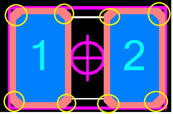

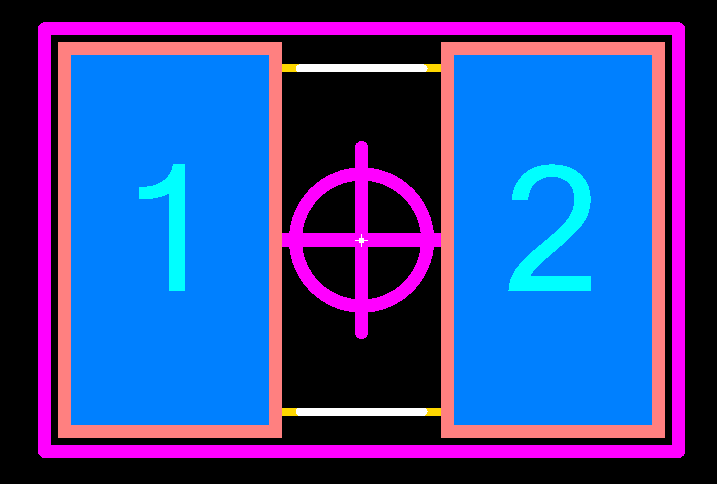

I usually use FP Designer.
Then I have a question regarding the corner chamfer.
The component picture has the solder mask oversize 0.05 mm equally.
I edited the pad stack to use the chamfer feature.
But but how do you make the solder mask oversize 0.05 mm equally?

I knew. I use the pad stack manager. But The program has only a Chamfer's length.
All I want to do is to have a gap between Top and Solder Mask Top.
