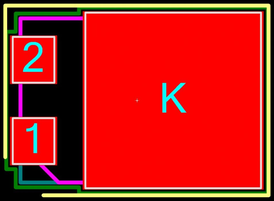

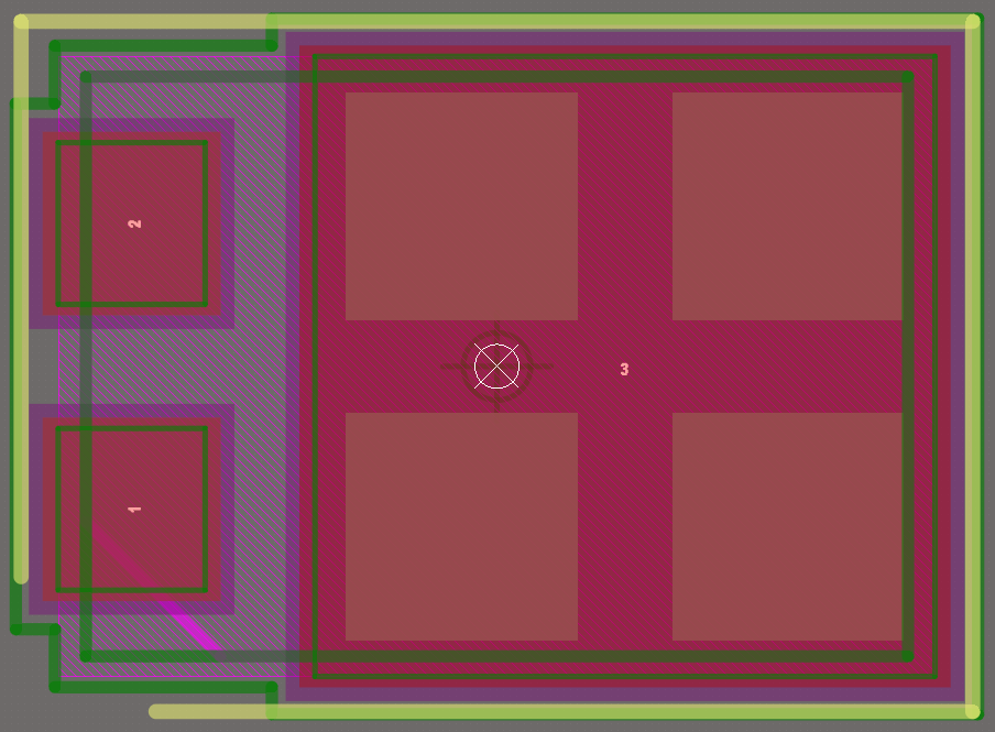

In the process of building a footprint for a SMPC component (standardized against JEDEC TO-277A), I found that a 3-pin DFN could do the job. The obtained land pattern is very close to the manufacturer's recommended footprint. Of course the pins should be reordered/renamed.
Is my idea of building this part out of a DFN3 good? Not advisable? And why?
Thanks!

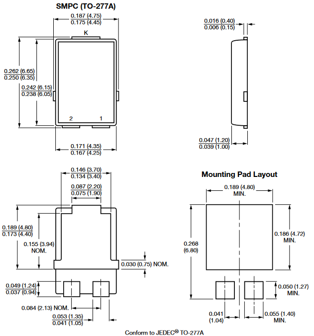

I add the drawings and datasheet for reference: https://www.vishay.com/docs/89335/ar4pm.pdf

The Vishay TO-277A Case Code is not a 3-pin DFN component family.
This footprint must be created in FP Designer.
There are 34 Vishay part numbers on www.pcblibraries.com/POD that have the TO-277A Case Code.

Of course it's not a DFN. But as soon as I use the FP Designer, I'm losing much of the features of Footprint Expert (3-tier density system, rounded rectangle pads, pad shapes drawing, Master options for batch generation, ...).
That's why I considered building it from a known standard package.
Thanks for your answer Wink

In FP Designer you have 100% control of the pad stacks like Rounded Rectangle Pads and Pad Shapes.
All non-standard package footprints should be created in FP Designer.
This is not a 3-Tier Density footprint. Only the mfr. recommended pattern will work correctly.
If you need FP Designer training, we can do a quick webcast so I can show you some great features.
