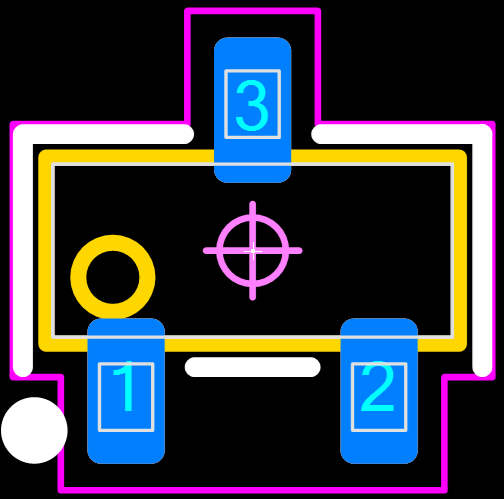

Here is a Silkscreen Outline mapping to the Maximum Body dimension:

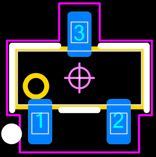

Here is a Silkscreen Outline using the Map to Margin with a 0.15 setting:
Map Silkscreen to Margin allows you too set a distance value for the Nominal Package Body to the Silkscreen. You determine the offset margin.
