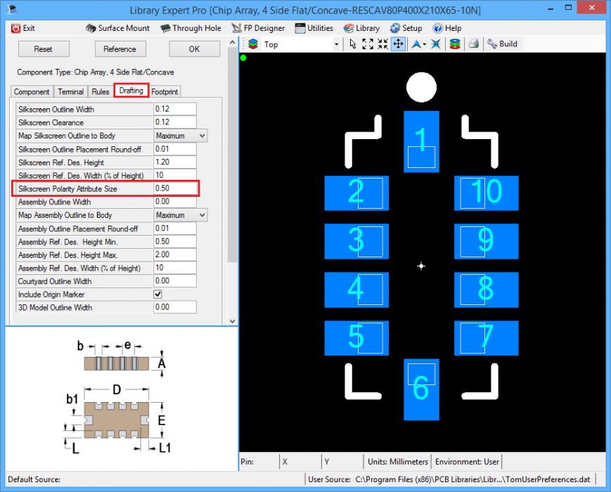

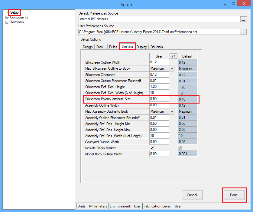

Post Options Post Options   Thanks (0) Thanks(0)   Quote Tom H Quote  Post ReplyReply Direct Link To This Post Posted: 26 Mar 2014 at 7:10am
We added your request for a Polarity Dot by Pin 1 in the upcoming V2014 release.
The dot size user definable and has Help Menu documentation.
User Preferences setting the dot size -
Calculator Drafting Tab to customize the size on-the-fly (for "Lite" users) -

Post Options Post Options   Thanks (0) Thanks(0)   Quote JZsori Quote  Post ReplyReply Direct Link To This Post Posted: 26 Mar 2014 at 7:14am
Will this be a true attribute in that it will be movable?
Post Options Post Options   Thanks (0) Thanks(0)   Quote Tom H Quote  Post ReplyReply Direct Link To This Post Posted: 26 Mar 2014 at 7:20am
For PADS Layout this is a Text Attribute and the dot can be relocated or deleted in the PCB layout.
For other CAD tools that don't support Text Attributes it will be a Drafting Line item.
